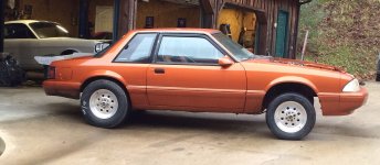

Ok guys I'm starting my second modfox build. This time I'm making less if a driver and more of a race car
Ok here's the new build thread for my second mod swap fox coupe. The drivetrain is a complete 2003 cobra engine/tranny/wiring and fuel system. The car is the little copper 91 lx coupe roller.
The mods are
-ported blower
-throttlebody
-upper pulley
-long tube headers, dr gas off-road Xpipe with spintech mufflers
-egr delete, smog delete, ac delete
-60 lb injectors
-upgraded 26 spline input shaft
-fidanza aluminum flywheel & aluminum cobra driveshaft
-center force dual friction clutch
-aftermarket shifter
-fore fuel hat with triple pumps
-zone 5 mdm fuel pump driver
-03-04 cobra fuel tank
-full suspension
-4.30 gear, 31 spline axles, c clip eliminators
-slight bit of weight reduction
-sct tuning software
-dark star big and little wheels
*New paint & color swap coming soon
^trunk monkey^ lol
^front end removed^
^old dash and wiring jerked out^
^new wheels^

Excellent looking forward to the build! Might be a tad much gear unless your running 28" slicks. 4.10's with a T56 and I'm almost at red in 4th gear.
