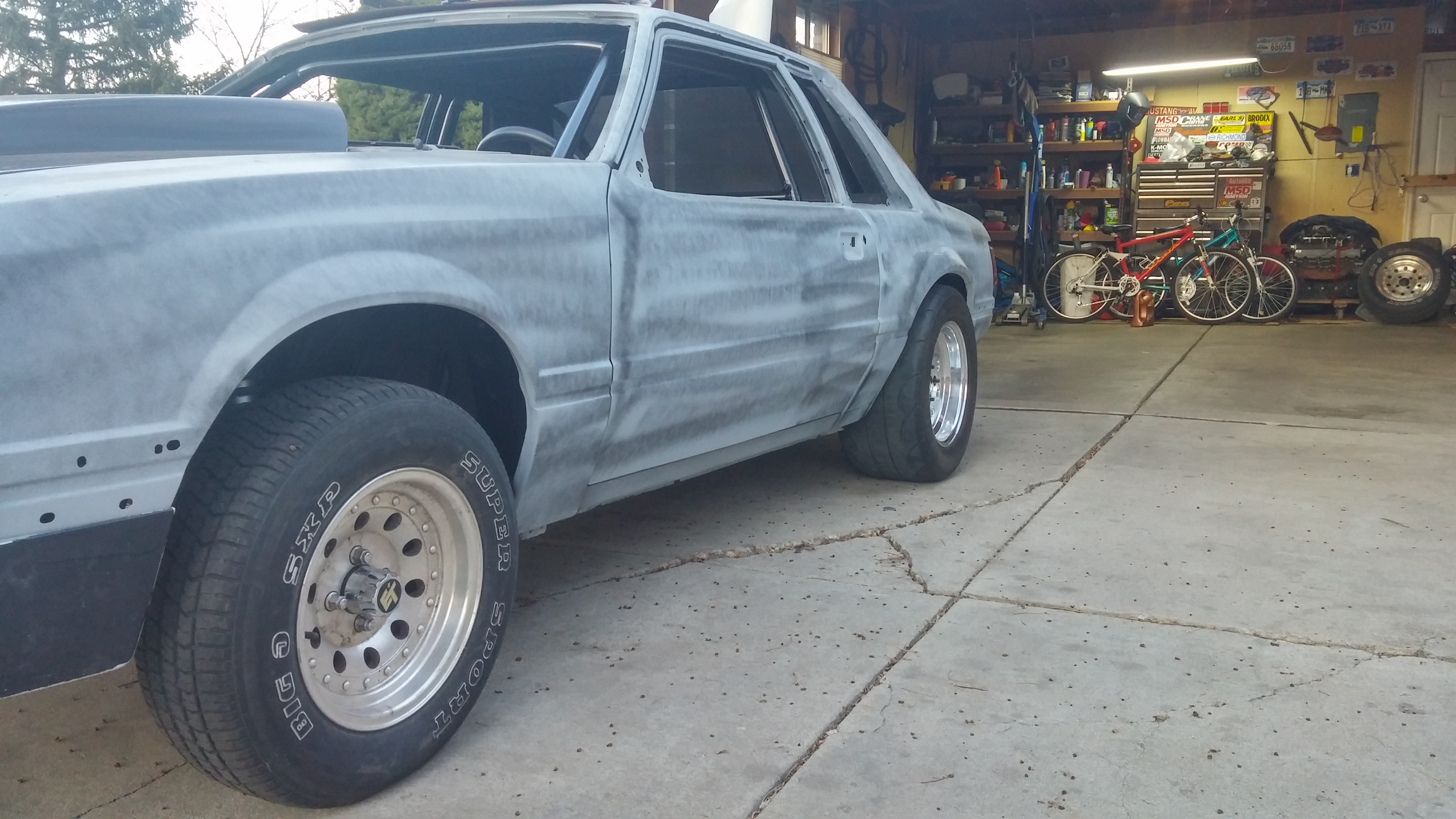

bad picture but you can see the rear tire and how it fits. BTW I have way too much pressure in the tires. It was at 15 PSI. Needs to be around 12 PSI.

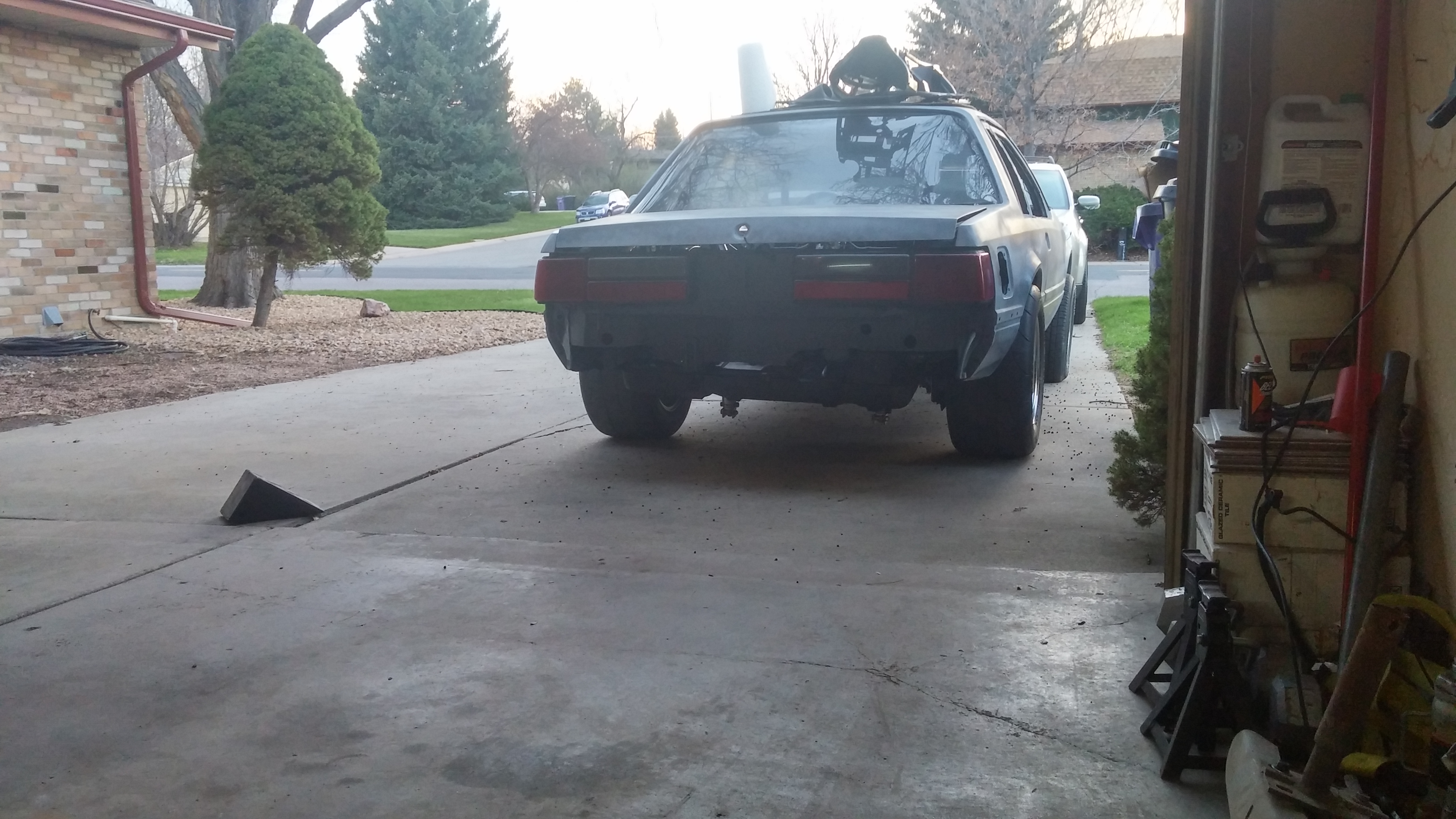

Im running 15x10 american muscle draglites with 6.5 bksp. 275/50/15 tires. Car has minitub.
Looks good, I'm thinking I might just keep my 18's and get some 295 toyo r888's. I'm possibly planning to make a larger flare on my quarters so it will be able to tuck under and have no rubbing issues. Not too much more, less than in these pics, and not rivet on fiberglass either, should almost look stock, just extending the current flare.
